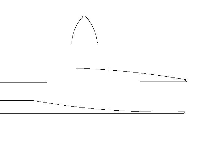

I too, am confused by what is meant by parabolic braces. In the following picture, all of the shape could be called parabolic provided that the curve is a section of a parabola. The top picture is a cross section.

[QUOTE=Mike Mahar] I too, am confused by what is meant by parabolic braces. In the following picture, all of the shape could be called parabolic provided that the curve is a section of a parabola. The top picture is a cross section.
Mike - true you can probably make any curve shape out of sub-sections of parabolas!
My interpretation (and I stress this is just my take on the philosophy) is that it is the top of the brace shape that matters so in your example the top two pictures are "parabaloid" but not the third as the curve is inverted and the brace has a dip and curves back up again.
Interestingly, with arched/domed/ tops and backs the bottom of the brace is also "parabolicish" shaped too.

[QUOTE=Dave White]
David, please excuse my crude drawing. The third picture wasn't supposed to curve back up; it was supposed to represent a section of a parabola. Also, the second picture probably should have started curving down sooner. Once again, this is because I'm using a primitive paint program to the drawings.
You are right in that in the third drawing it isn't the brace that is parabolic but the cutout it. ie the brace lies outside the parabola. In the second, the brace lies inside the parabola.
I'm inclinded to think that, if you are going to use a precise mathematical term to describe something, you should try to it. I'd be more likely to just say curved braces as opposed to scalloped or straight.
